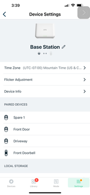

bcmacman

StephenB
@bcmacman wrote:
What base model do you have?
FWIW, I am seeing the HomeKit option on my iPhone 12 mini.
bcmacman
VMB 4000
iPhone 13 Pro Max

bcmacman
Have done that.....still no Homekit option.
bcmacman
No base station in Homekit
JessicaP
Arlo Employee Retired
Hey bcmacman,
Make sure you have "Home Data" permission enabled for the Arlo app. You can do this by going to your iPhone Settings > Arlo > Toggle "Home Data" On.
Then go to the Arlo app and you should see HomeKit for your device and try setting it up from there.
bcmacman
That did it!!  Thank-you.
