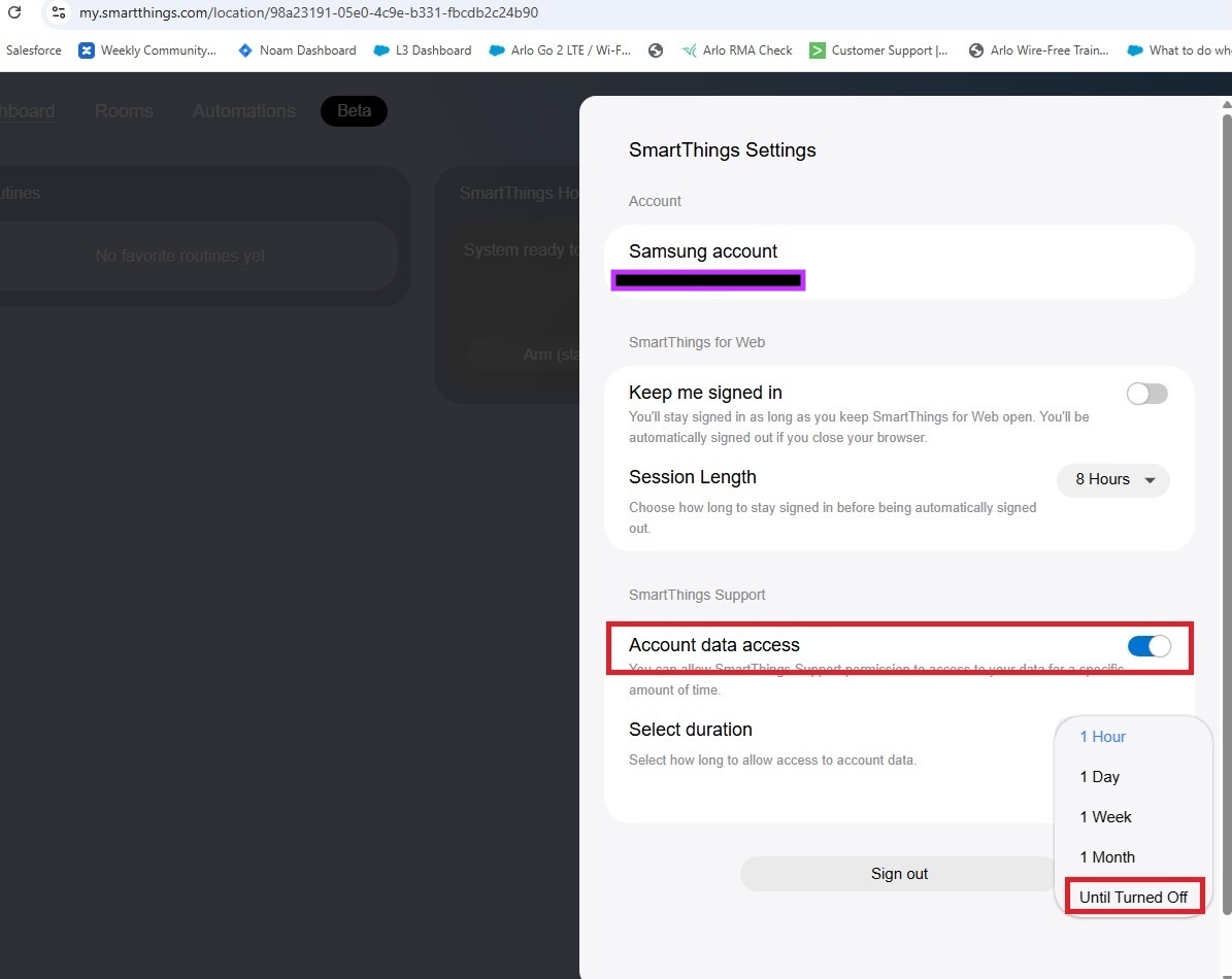

@Driver468
Is it possible for you to send a screenshot of this data access screen.
Driver468
Should I turn data access on? It is off right now.
ShayneS
@Driver468 Yes please, and let me know if you see any improvements.
Thanks!
