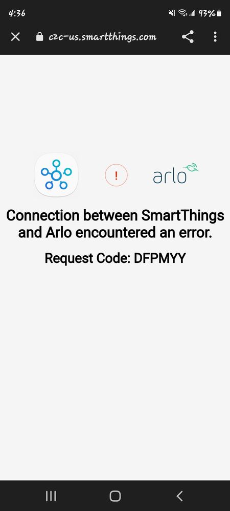

See attached picture

This morning my cameras now show up in the list after linking to my Arlo account but I can't add them.
When I get to the page that list all my cameras I have a done button and a list of all 4 cameras but all I can do is select done and then it takes me back to the add page and nothing is added.
