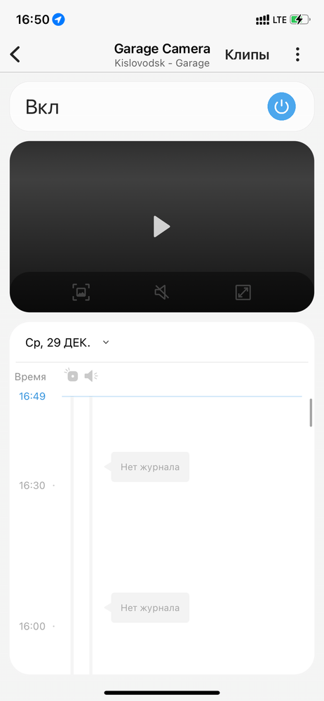

why does this topic have the status resolved!? The problem is not solved as far as I understand! And even if you follow the advice and add cameras with an update in the services section, this will not solve the problem with the sound and motion sensor.
Integration with ST is clearly broken, and ST support looked at all the logs and reported that there were no errors on their part!
