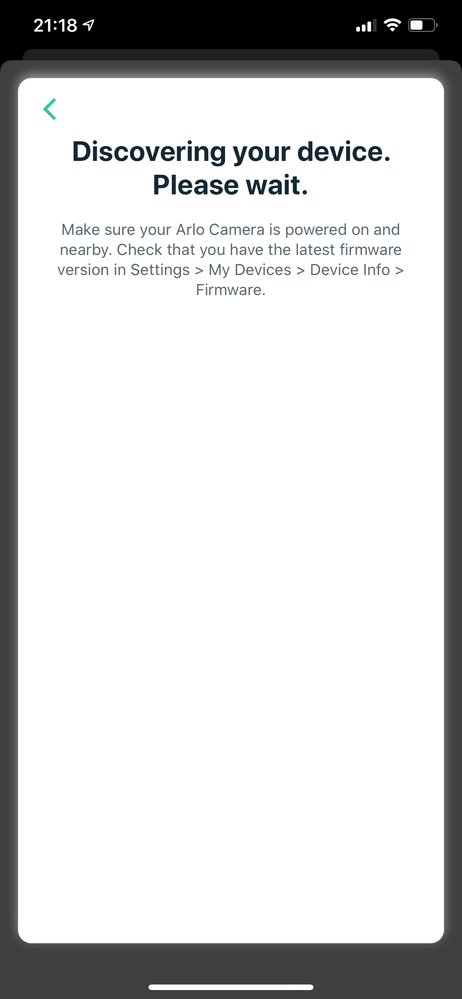

I recently updated my hub from the VMB4000 to the VMB5000. I have all Arlo Pro 2 cameras but upgraded the base station for future camera upgrades.
When I was readding my hub/cameras to HomeKit, the “Discovering Device please wait...” just spins in endless cycle. I’ve rebooted the hub, redownloaded the app, and rebooted my iPhone (XS Max running iOS 13.2.3). I thought I was getting somewhere when I redownloaded the Arlo app, it asked to communicate with my HomeKit but when I try to add the devices, it just spins.
Any ideas to get past “Waiting to discover...”?

I was able to resolve the HomeKit issue over the phone. The issue was I had the Arlo base hardwired into the modem and not the router. When I hardwired the base into the router, HomeKit would then recognize the devices to add to my home.
Thank you,
