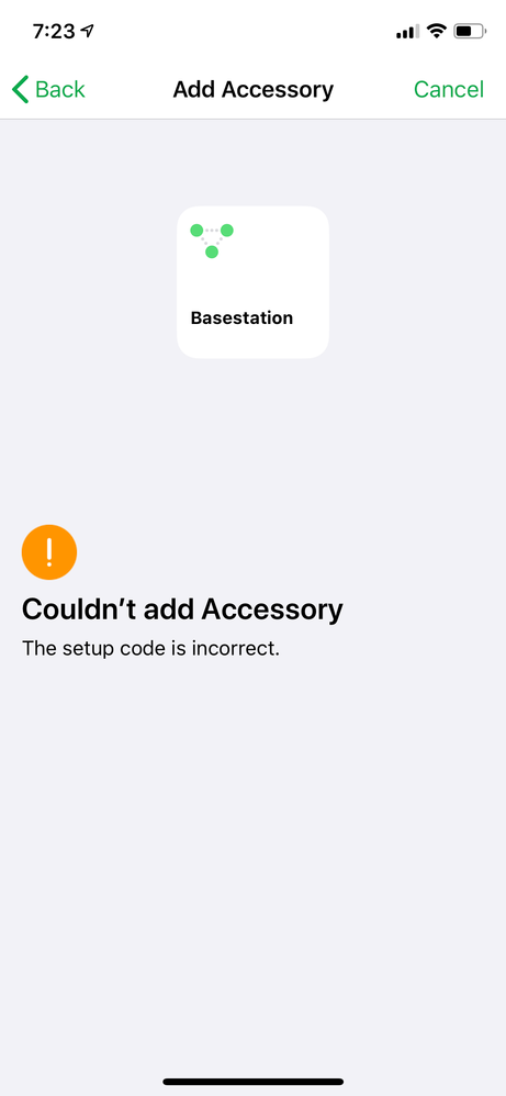

I’m really not sure how you can add the arlo base station to homekit directly? Where did you obtain the homekit code from?
Arlo just appeared in Homekit with my other accessories. I don't remember if it came up directly on the new home page, or under add accessories page, but I had a page that did show all the accessories that I had added before.
