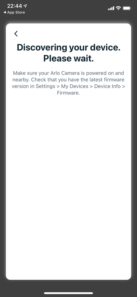

Same problem in The Nertherlands. Iphone 12 pro. Deleted the Arlo app several times. It does have the Homekit option but when I tap on it it will keep on searching for devices. Alle devices are up to date. Please some advice.
I have reset your HomeKit token, please reboot your base station & try and add your device again.
