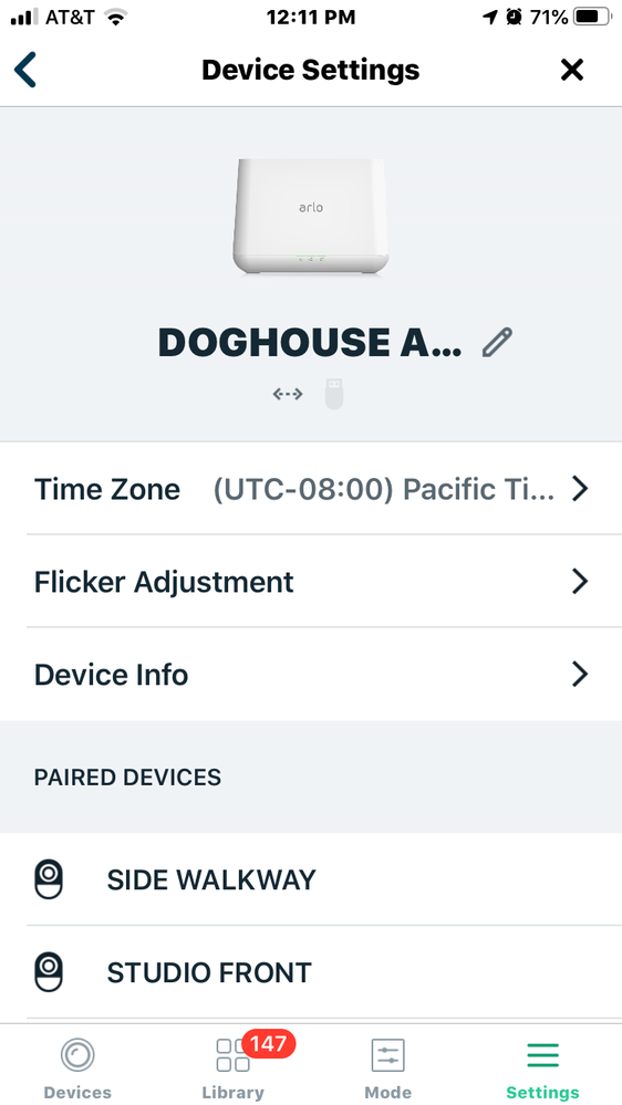

Thanks for your response. No, my base station page has everything your screenshot has EXCEPT the Homekit part. I attached a screen shot. Any ideas on what I can try now?
Base Station model VMB4000r3
Firmware 1.16.2.3_3499_ccd29a0

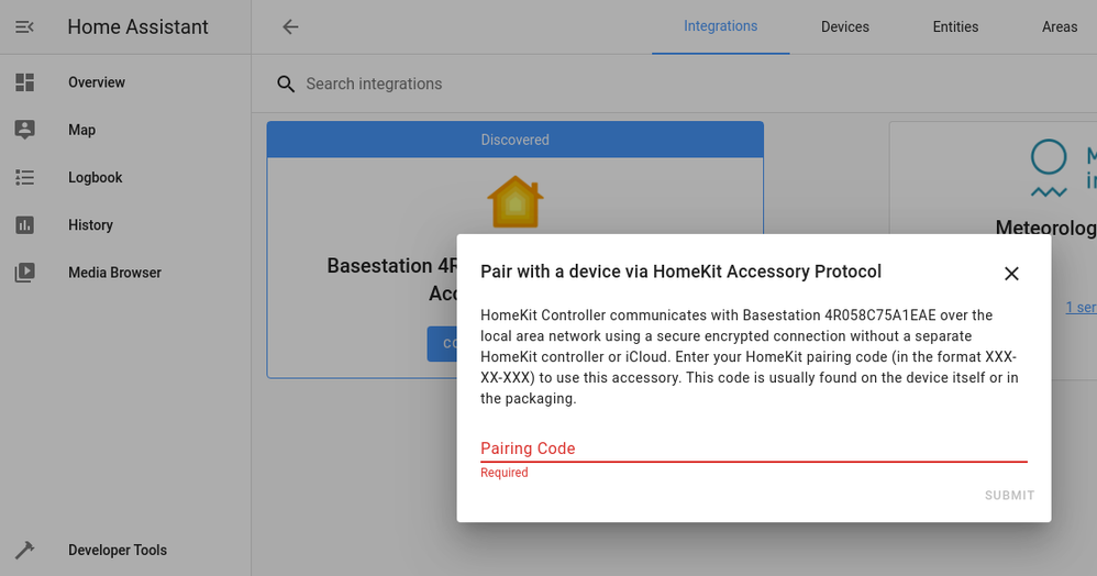

I have the same problem. Bought the 3 camera system and was setting up Home Assistant and stumbled across this. Did some digging and found that it detected the base station as a HomeKit device, but I don't have the menu option in the screenshot above for HomeKit. Looked through my quickstart guide, no code, which is why i looked in the app, and no button.
Running Firmware v1.16.3.4_3614_c289687 w/ hardware VMB4000r3. Was bought new from Amazon.

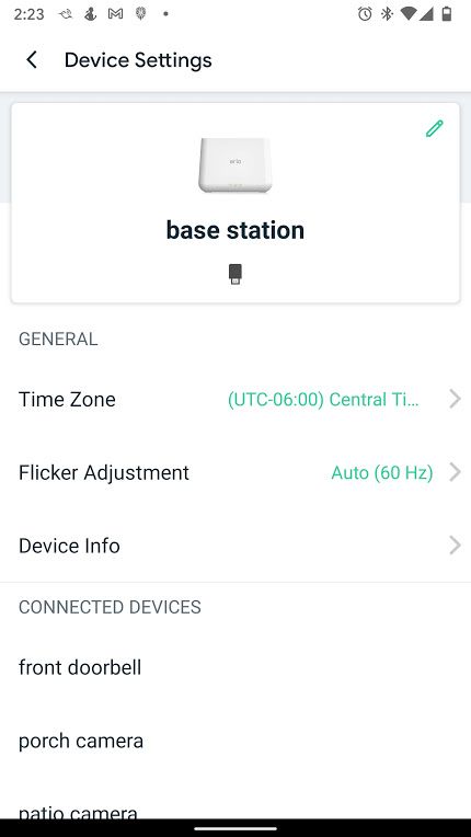

Don't know if this helps, but I'm also trying to set up HomeKit through the Android version of Arlo.
@ShayneS Yes it is missing.
Thanks for that info, Can you please provide a screenshot of this missing button by chance.
@ShayneS forgot to tag you on the last post so don't know if you saw the screenshot but it's in the previous post.
