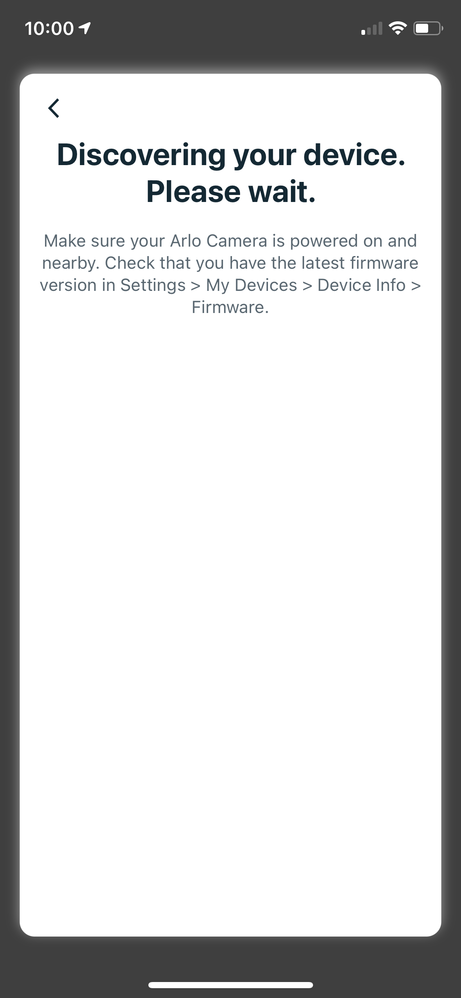

I had HomeKit set up but then removed it because I was reorganizing things. Now when I try to add my base station again the app just gets stuck on "Discovering your device. Please wait." I saw this posted elsewhere for a different hub and support sent a token reset request which seemed to resolve the issue for others. Is that what I need here?
Hi dvmeeks,
I've sent a token reset request to your Base Station/SmartHub that should resolve the issue. Please reboot your Base Station/SmartHub (remove and reapply power), allow the Base Station/SmartHub to come back online and try setting up HomeKit again using these instructions: How do I connect my Arlo camera to Apple HomeKit?
