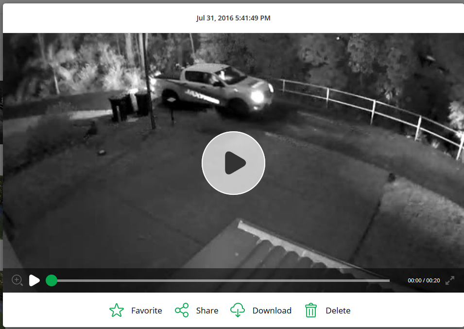

Below is my driveway camera. As you can see near the wheelie bins there is a silver light pole. I had to angle the camera down as the light at night would have interfeared with the motion detector (last image). I have the motion detection turned right up to about 95%. below you can see that it still triggers at night with a large object. So I should be setup for the main area of interest.

1) The light on the pole won't affect motion detection since it's not moving.
2) The motion detection area for the wireless cameras is the entire view (maybe even a bit larger). The use of a passive IR detector precludes the ability to zone areas. The Q cameras have zones because they use a pixel-based detection scheme.
Depending on what you're actually interested in, I'd still rotate the camera down to eliminate the road/drive. Since you are detecting people walking the choice is yours - you'll just be getting more recordings and lesser battery life recording inconsequential objects.
