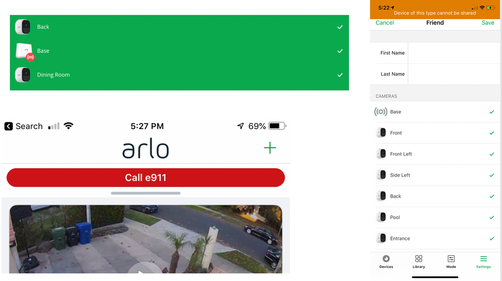

in the iphone app, there is a dropdown on the main page, just below the ARLO logo that shows 3 options: alarm /call friend / call 911
When granted full access to the system to a family member, only call 911 shows up.
I called support, they said this is normal - only the primary member can stop the alarm.

In the list of devices to share, I see the "base", and the cameras. I do not see "Siren".
When editing the list, the app allows me to select the base, however, when I save I get an error: "Device of this type cannot be shared".

Can you show me a screenshot of the error you receive? Do you see this same behavior when using both the mobile app and the web client?
on the iphone app, the base/siren is showing as shared however when I shared it, it showed an error
on the web, the base/siren is showing as shared.
but on the grantee app, the base is not showing
see attached screenshots
