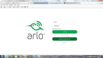

here is the link and the screen shot for new system setup
hope it helps
