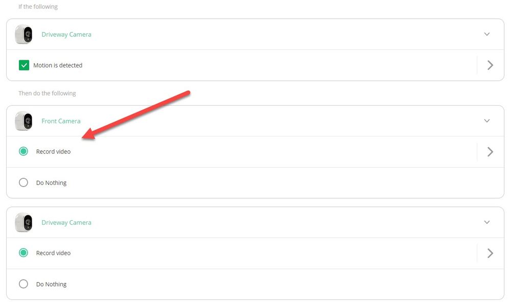

I have two cameras that I want interaction with. A "Driveway" and "Front" camera. The "Driveway" camera triggers more and is closer to the action. The "Front" camera is more distant and has a wider more all encompassing view of things. It triggers less even after modifying motion settings. I edited my "Armed" rule for the "Driveway" camera so that when it detects motion "Then do the following:" to add have the "Front" camera start recording.  I see that the cameras now appear synced on the "minutes ago" and show a screen shot of the same event in the preview for both cameras. The problem is that I have recorded video for my "Driveway" camera but not for my "Front" camera even though it has been told to record via the rule.
Any help would be appreciated.

Drew1689
Yes, I can trigger the "Front" camera directly and it record video consistently.
What is odd is the preview for both cameras show the same event scene but there is no video in the library for the "Front" camera. Just the "Driveway" camera. This happens every time.
I really don't want to turn up the "Front" camera sensitivity any more, I would just like it to record when my "Driveway" camera records.
