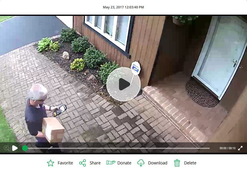

This is a gen 1 Arlo cam video below... I had to move it away from the door and change it to facing the door. It triggers as they enter and faces as they leave.
One issue i see is users trying to cover to much area for the camera..remember they can only pick people up at a max of 20 ft, so your coverage should be slightly less.
As you can see it's the start of the video, also no trees or much else to get false triggers from... so if you have these items, try to eliminate them from the view
