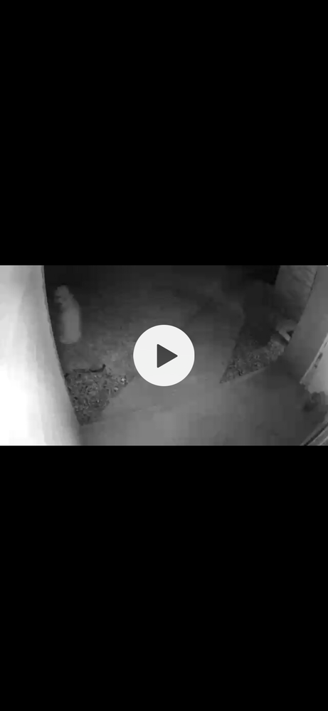

Not triggering for recording
Nothing was attached. Post a link to the video or save a screenshot and use the Choose File button here to attach it.
Missed recordings are usually a function of camera positioning and sensitivity. Motion should be across the FOV and not at the camera. Increasing the sensitivity in your modes and rules may also be needed.

Increase the sensitivty of your camera and the position, then test this yourself on the live app.

The sensitivity is at 100% and I have moved it around and it still has this issue...
I would gues sthat the person's approach is from the sidewalk wich is fairly close to being at the camera. Note that there's a 2-3 second lag between detection and recording as the camera has to set up communications with the server before actually recording (such is the nature of cloud recording). In this case, mounting over the door or even to the right of the door as seen from your image would likely be preferable.
You are changing the motion sensitivity in you rmodes and rules, right?
It's worth a try. You want to get as much motion across the FOV as possible.
The likely problem is that the walkway is basically pointed AT the camera. You need to position the camera so that it's more or less ACROSS the FOV. From the sidewalk, your camera is on the right - I'd suggest moving it left, closer to the wall I see in your snapshot. That way you'll miss some motion coming up the walk but the camera should be much better at picking up the motion when the person does appear.
