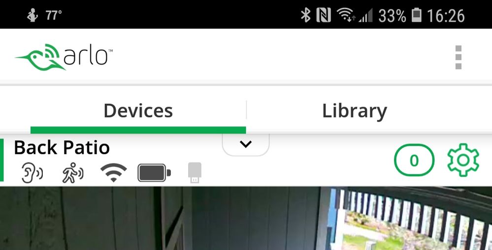

The mode tab won't appear on our Android apps any more. The only tabs visible are now Devices and Library.

Arlo app is not showing a option to set the alarm any longer. Did this go away I tried resetting base station and re-installing the app.
Mode tab on Android app disappeared yesterday. I have rebooted router, Arlo box and reinstalled application, still nothing. If I go in via the web it is there. Any thoughts? past the 90 day mark so afraid Arlo is going to want $s to fix their app issue.

I tried re-installing the app, but there was no change. All there is, is DEVICES and LIBRARY. Settings is for the camera settings, profile and system. What I need is access to the MODE feature in the app. Can anyone help with this? Is this a programming glitch and update error by ARLO or are they getting away from mobile ARMING and DISARMING. If that's the case, I feel I need to begin a case with the Better Business Bureau of Canada as this is clearly misleading advertisement... and or a major defect which mean I could technically return the product as I'm still under waranty as well as my Master cards' extended waranty. Obviously, I'd prefer a solution to this problem by the ARLO programming team.
