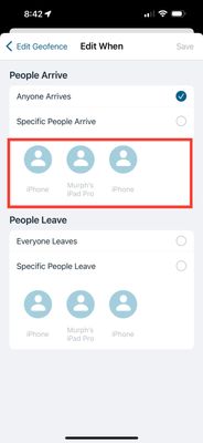

I'm trying to set up leave/arrive geofencing in my house with one Arlo Pro camera. My wife and I each have an iPhone. When I'm in the app and go to select "when specific people arrive" for instance...it shows three options:
iPhone
Murph's iPad
iPhone
I don't even have the Arlo app on my iPad so no idea how that device is listed...can I remove it?
Also, is there no way to differentiate between the two "iPhone" listings? I'd like to be able to tell that it's my phone and my wife's phone.
I'm on the new 4.0 app with the new dashboard and there doesn't seem to be any place to edit this list so that it's "correct". Do I just have to live with the list as Arlo is presenting it?
Thanks!
Not sure this will will help but have you checked your profile? Click on the "person" icon to go to the profile and check your login settings for 2FA. Select Edit so you can delete old/unused entries. ALternatively, check the settings/accounts for anyone who you have granted access to your system.
I recently posted about this. I was told that the first device listed is your device. (regardless of name). So I selected the first device and my geofencing did work again. But idk for 2 devices.

How can I make it so I can see the names of the people in the configuration screen? They both just say “iPhone”
I see the same thing on Android. The likely "solution" is to remove all trusted devices and add them back in with unique names (people and/or device).
How would one do this?
Edit your profile (person icon top left). Click on your name/Account Profile, Login Settings, Two Step Verification and then Edit at the top right.

My wife is added to the "people" list in the app with admin permissions. However the automation fails to disarm or arm with her phone. Her iphone is the same model with the same permissions and settings as my phone (which does work correctly). I fail to her her device listed in the Routines/automations/Specific people... Should I see my wife's phone there? I have been using Anyone Arrive or Everyone Leave Options, but this does not work. I've tried Specific people as, but with no luck. Also the devices listed there just say "iphone" and are not editable nor can I remove an old device. Something that needs to change in the app....
Thanks for any suggestions.
I am having the same problem. When using a product that is called "home security system", I don't see how having "specific people" called "iPhone" is OK. This is a serious problem; we need to know "who" this is; what "device" this is. Also, I'd like to be able to rename that device to something useful; that is if I could tell what it was. I would also like to be able to add/delete from the "specific people" list. I'm glad I'm not the only one seeing this; I'd like from someone from Arlo to admit that this is a problem, and that they are working on. As a user, trying to secure their home, I need this feature to be working.
