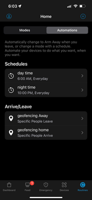

Yesterday I received my new arlo alarm system. I updated to the new app and installed the system. I set up a leave/arrive automation and the geofencing only has the option to select old iPhone devices that i don’t even use anymore. Prior to yesterdays update, my geofencing was working fine.
Please help. Ive deleted that app, I’ve changed the location services in iPhones settings on and off, as well us under the arlo app settings. I deleted all trusted devices, I’ve logged on and off, and geofencing won’t have my current iPhone as an option to select.

Support already tried the privacy centre and it only shows my phone and its only shared with my wife (who also only has her phone showing). However, I can still 9 devices when trying to use automations!
I currently have something that works for now but even though it's just me and my wife I have to have 3 of the iPhone devices under my account selected. Makes sense, right? 😡. However if we go away, my overnight automations just break.

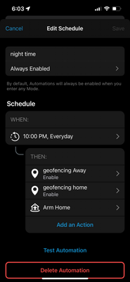

Next is the ability of schedules to check device location status. Is there a fix for this?
My want: a schedule which arms all outside cameras at 9pm at night, and disarms at 5am in the morning. If all the devices are away from home, the 5am schedule should leave the devices armed.
This used to work on the old app.
I believe this is already a capability?
I can set it up, but it doesn't work. When the schedule runs at 5am it simply disarms all cameras. The location based automations (Arrive/Leave) appear to only work if someone arrives or leaves. It doesn't periodically check to see if everyone is at home or away. So if everyone is away then the cameras end up disarmed. Caught me out the first time we went away for a weekend. Now I have to manually disable the 5am schedule whenever we are going to be away overnight, and manually enable when we return home.

@bryceee you've probably tried this already, but I recall you can disable the schedule when setting up the automations, so if you do that for the Arm Away automation, the schedule should be cancelled until the mode changes back to your home mode. I can't test it as I've managed to get back to the old app (hooray!!) but just a thought. Would be good to know if that does work though, as it might convince me to upgrade again?
Thanks - I’ll try that again. I think the first time it failed because I couldn’t work out that I needed to select 3 devices for me and my wife’s phones 😕 Didn’t think to go back and re-try!
