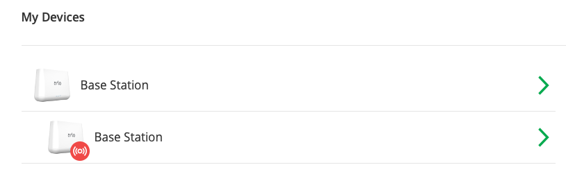

Additionally, the way the Base Station is showing up on the portal is weird, see attached picture. It does look like are two of them. The one with the Red Signal does not have any further information and cannot be removed.
That's the siren part of the base so you can rename it separately to help keep track of what alarm is being used.
