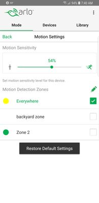

Im having an issues also. Its under Mode > Pencil of mode id like to edit > Pencil of camera id like to edit > Pencil next to "Detects Motion" > Motion Detection Zones.
Default is "Everwhere" selected, I can create a zone and name it, but cant change color or select the zone after creation. Zone "Everywhere" cant be unchecked.

If you look at the screenshot below, this is what I'm talking about. Like @Moser said .. Its under Mode > Pencil of mode id like to edit > Pencil of camera id like to edit > Pencil next to "Detects Motion" > Motion Detection Zones. I can create "Zone 1" which excludes some bushes/trees that always trigger my camera...but I can't enable Zone 1 or disable Everywhere.
Is there any Arlo documentation that states the Motion Detection Zones only work for Arlo Pro? Seems kind of odd that the feature is shown in my app... I can actually go as far as to create the zone by highlighting an area of the screen....but it won't let me enable?

Just installed Arlo Pro system. Setup Activity Zones but unable to select those zones in the Motion Settings screen Its stuck on the 'everywhere' zone and I can change it. I have the Arlo Smart premier subscription and am running these on battery only. What do I need to do to activate the new motion detection zones?
Firmware: 1.092
Stuck on 'Everywhere' zone

Just to be clear so that nobody tries to confuse this again, this is NOT the same as the Smart Zones or Arlo Smart. This is specifcally called "Motion Detection Zones" and is a setting that has very recently been added to the Arlo app for Arlo Wire Free.
I look forward to them getting this working because I'm grateful for this feature and was pleased when i noticed it today, but then quickly disappointed when it let me create the zones, but not turn them on 😞
