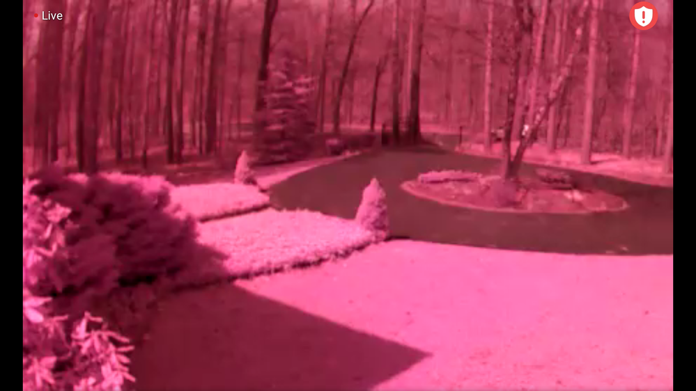

I just set my Arlo system up over the weekend and been testing it for a couple days. Both cameras don't seem to be sensing motion until right in front of the camera. I don't get notifications every time it does sense motion. One camera is live and recording in red color video. Let me know how to fix

The red tint is an artifact of the IR filter used for night vision. About all you can try is to open and close the battery door to see if the filter will unstick itself. A moderate jostling may also be useful. If not, it's a hardware problem and can only be solved by swapping at the store or use of the Contact Support link at the bottom here.
This might also do the trick: https://community.arlo.com/t5/Arlo/Red-tint/m-p/1299751#M36719
