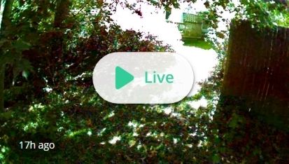

Here are the video thumbnails showing in color.
Working on getting the videos posted.

Here are the links to two videos, one for each camera, that match the thumbnail photos already posted here:
https://youtu.be/f1Lgt1sghks
BTW, this only began to occur AFTER the recent base station firmware update.
