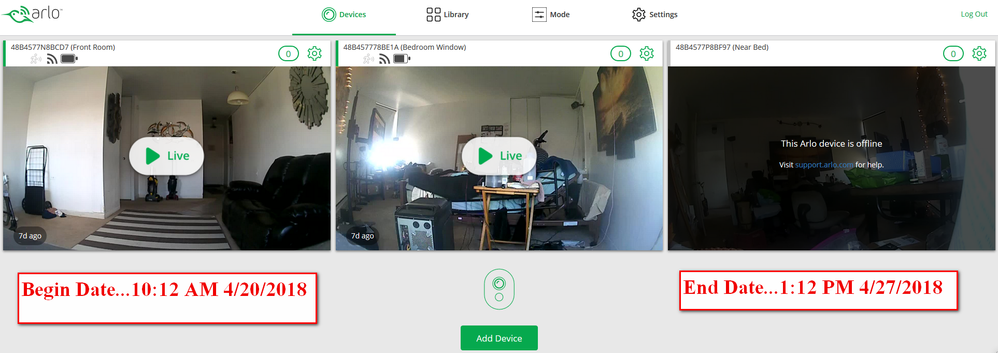

For test purposes, I'll use these two cams:
48B457778BE1A (Bedroom Window) which is charged at 76%.
48B4577P8BF97 (Near Bed) which is charged at 90%
Camera 48B4577P8BF97 is the *problem child* <Lol>, and I swaped them both at 10:12 AM 4/20/2018. Both cameras are also in DISARMED MODE, and I'll post the results over time and/or if any issues occur.
8:00 PM 4/24/2018: Present status update:
48B457778BE1A (Bedroom Window) reads at 67% charge level.
48B4577P8BF97 (Near Bed) reads at 88% charge level.
On each camera, approximately two 2-minute "Live" views were done the other day, and one snapshot was performed with each camera. All charge level readings are based on my online account 'meters'.
1:12 PM 4/27/2018; Present status update:
48B457778BE1A (Bedroom Window) reads at 65% charge level.
48B4577P8BF97 (Near Bed) has NO charge level. Instead, my account indicates that "This Arlo device is offline."
A few minutes ago I noticed that the amber light was blinking on Camera 48B4577P8BF97, and the unit is not working. I DID NOT receive any low battery email notifications for that problematic camera, either.
This same scenerio has played out many times for several months now and I'm beginning to feel totally frustrated this time.
What should I do now???
