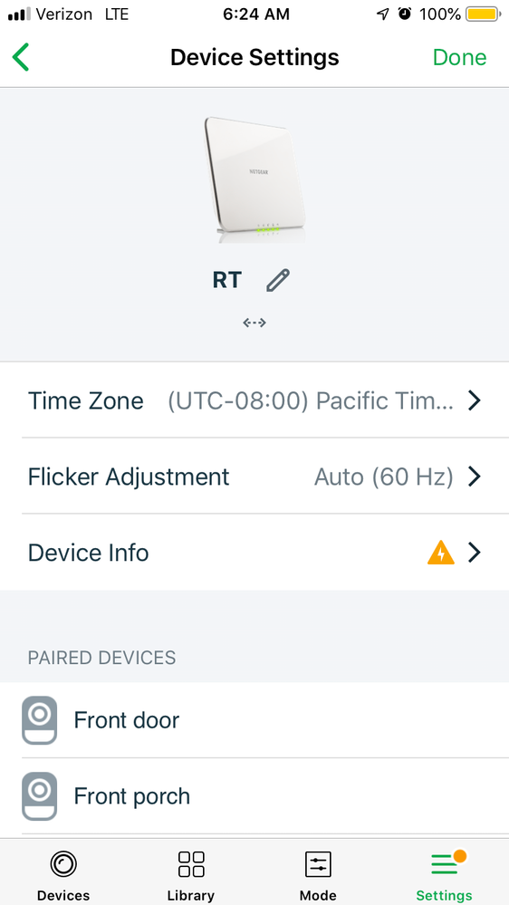

Reboot your base - that usually fixes timestamp issues.
I am having the same issue. Logged into iOS app to find nothing was functional based on "Base firmware upgrade required", I have attempted this and when it seems to be complete, my cameras are still not functional, and I keep getting the same notification to upgrade firmware starting with the base. I am curious if anyone with the same issue has been able to resolve and how? Seems like everyone here is still stuck with the issue.
I'm guessing the unit might have rebooted itself. It was exactly -8 off UTC, so presumably its default is pacific time. My settings in the web interface weren't showing that though - perhaps the base station hadn't applied those settings until a reboot or some other scheduled event that checked it. You'd think / hope that if it were necessary, it would happen a lot faster than it did (but of course I don't have access to the unit's logs to determine this).
