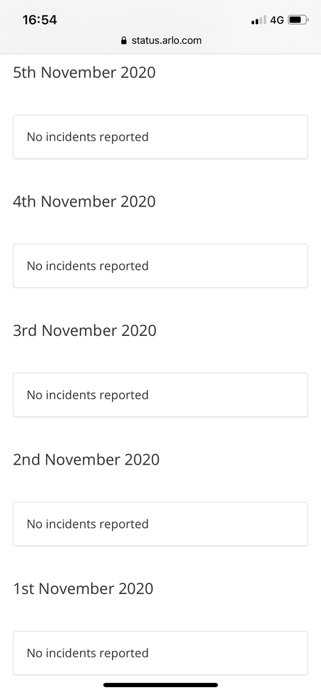

System down since 3 days, why in Arlo Status all is ok?
