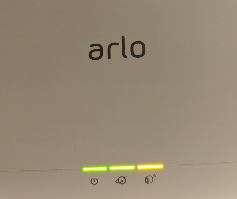

If this isn't what you mean, what are th LEDs on the base showing? What do you mean by having "reset" twice? There's a big difference between power cycling the base and an actual rest using the rest button.

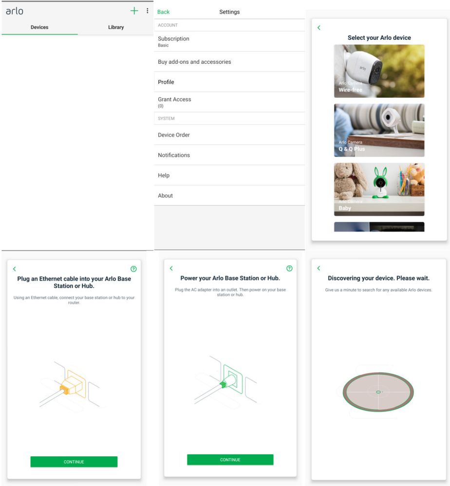

for starters I have the 4000 series and no the base in not in my settings, when I try to sync a camera the app wants to find a base stations first and no camera to be found in my devices, when I reset I took a paper clip and put it in the tiny hole in the back, I have also done power cycling. and for the past two days I have been doing is....
open arlo app, add device, "select your arlo device", "arlo camera wire-free", "plug an Ethernet cable into your arlo base station or hub" continue, "power your arlo base station or hub" continue, "discovering your device. please wait" For eternity "do not pass go, Do not collect Cameras" because it wont find anything base station or camera. I don’t know what else to do please help.

You must claim th ebase first. If you have no devices listed in Settings, My Devices, the reset button should be used. You don't mention how long you held the button in - it has to be until the LEDs flash amber. Once it's rebooted and the power and Internet LEDs are green (the Camera LED sould be out or solid amber) you can claim the base by using the Add Device button (web) or + (app). Only when the base is claimed can you then sync the cameras by briefly pressing the base sync button (don't hold it) and then the camera sync button.
