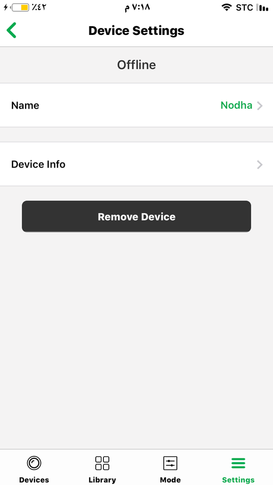

The system was working well and it suddenly showed me this application message (Your base station is offline Check if it is powered up and connected to the Internet.) with internet science working well! What?
The problem ended after deleting my account in the application and creating a new account and synchronizing the cameras as a new user for the system Arlo / Was not the problem of the net or cable or camera or modem
Can I ask you how you did that?..I've done every step that the company says to do, and it's still offline..
The base station was online and cameras synced...another router was plugged in and kicked the base station offline...have read that it should find the router fine, and jump back online...I've tried everything suggested by the company, and the base station is still offline..
I thought the problem was the base station, and not with the cameras? .my base station will not go online no matter what steps I take..you said you deleted your account though, and started over?
From the settings then My Devices then enter the name of your device and delete it / then enter the application again and add your device
