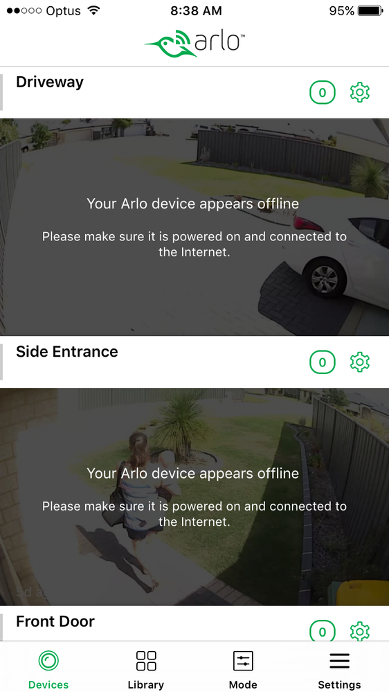

Power cycled the base station and deleted and reinstalled the app.
Bloody thing still offline.
Glad I bought the set just recently, because if it doesn’t work by the weekend it’ll go right back to amazon.
Resetting the base station could be something I’m willing to try. But no way I resync all the cameras. They are mounted around the house. If I have to take them down they won’t go up again......

The 3 leds on the base are lit green.
The lan cable in the base station definitely works. Tried that (by plugging it into my laptop).
I tried the app on my iPhone. Reinstalled the app, tried again. Tried it on my home WiFi as well as cellular from work. Tried the app on the iPad.
Tried the website in internet explorer.
I restarted the base. Via the button on the back and by removing the wall plug.
Result of all this: base station and all cameras still offline!
It'll be a PITA but the fastest thing to try is to start fresh. Note all your settings and modes/rules before you start. Remove all devices in Settings, My Devices. Use the Add Device button on the Devices tab to claim the base. Sync the cameras. All should be good. No explanation for why you would need to do that.

i was ready to reset and reconnect everything. So I deleted the base in my app. Then I thought I’ll try to add it again without resetting it first. The app then showed the base as connected but I didn’t get any live picture. After a hard restart of the app it actually worked again. Without reconnecting any of the cameras. They were still there.
