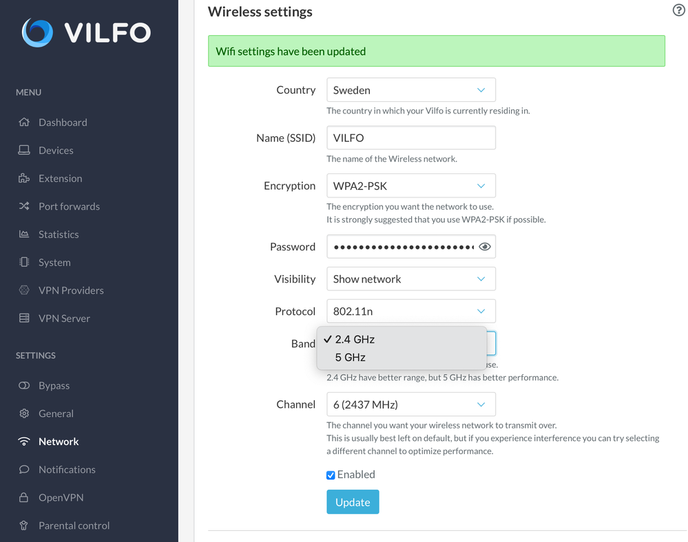

Ok.  I didn't see an option like that in the documentation. Maybe post a screenshot of that screen?
BTW, the current app is 3.5.12 - you might try updating that.
stonebridge26
See message #6 in this thread, i am already on app version 3.5.12
Here´s a screenshot of the router settings with the 2.4 band selected

FWIW, the most routers with 2.4 and 5 ghz radios let you use them both simultaneously.  It is rather odd for one not to have that.  Though I have now seen reviews that say the Vilfo does have that limitation.
with their focus on VPN capabilities rather than WiFi performance, the Vilfo can only transmit and receive on one band at a time. You must select either 2.4 GHz or 5.0 GHz
Despite that drawback, it looks like an interesting router.
But it looks like you are already only have a 2.4 ghz network running, so I think their support will tell you that 5 ghz is already disabled.
