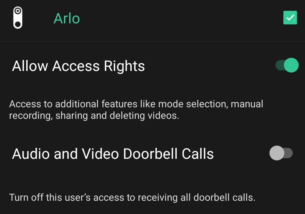

I'm the main account holder and I want the calls where she doesn't
Any ideas?
Thanks
Micjam,
Which setting are you referring to? Is she logged in using her own account via the Grant Access feature?
Micjam,
Has this behavior always occurred? Was there ever a instance where this worked correctly?
Are you able to easily reproduce the issue?
Micjam,
Is this still happening with the latest version of the Arlo mobile app installed?
The next time it happens can you provide a timestamp for the occurrence (example, 5:37 pm PST 06/16/2022).
Thanks,
Micjam,
Try toggling the feature on and back off again, then log out of the shared account and log back in. Do you still experience the same behavior?
I tried this but it still calls my wife's phone.
Micjam,
If you remove her as a friend completely, and then share again. Does she still experience the issue after accepting the new invitation?
It doesn't seem to make any difference.
