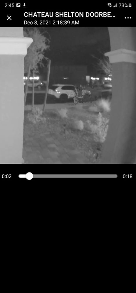

For a while now, my night time video recordings have shown severe pixelation. Mostly with vehicles (see attached picture) but also with people walking by if they walk fast.
Version is 3.5.8 released Oct. 12 2021. According to my app, no updates available.
Motion is set at 80.
Motion sensitivity is set at 90.
Flicker adjustment is set to “auto”.
Brightness is set to 0.
Video Settings:
Auto HDR “on”
Night Vision “on”. NOTE, turning this OFF made no difference.
Video quality 1536sq.
This is a wired video doorbell.
Thanks for any help you can provide!

From looking at pic, there is a LOT of reflection of the IR on the left side of picture....
This may be washing out the video/stills of the camera ( wreath on wall ?? )
Move the object and see if it improves the vids.
Hi TomMac and thanks for your quick reply.
I’ve had the camera/doorbell for almost a year now and the problem started a few months back. The left side you see is a brick wall so can’t move that. 🙂 🙂 🙂 No wreath or anything hanging near by. I made a 1.5” block to mount the doorbell on so the video doorbell would “stick” out a little further to give me the most video area possible.
Can’t move the doorbell as it’s wired.
This has me stumped as like I said, this started a few months back and I’ve played around with the settings.
