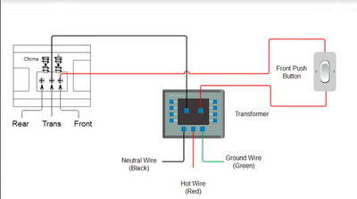

I have checked the Chime will received 220V from main DB and deliver output to gate switch is 12V.
So I get the wiring diagram from US DIY doorbell as below :
- For the transformer can I use the below link adapter
https://shopee.sg/product/44824231/12365650080
*Input: AC 230V 50Hz
*Output: AC 18V 500mA 9W
- The push button replace with Arlo video doorbell
- For chime I will get from the below link
Regards,
Vasanthan
In the diagram you posted it looks like 220 v is connected directly to the doorbell chime. This is not how it is done in the US. A transformer is mounter somewhere in the house to make 12 to 24 volts and than there is low voltage wiring for the doorbell chimes and buttons.
Is the doorbell button also 220 volts? I suspect there is a transformer built into the doorbell chime but cannot tell from that diagram. Can you give us a model name or number that we could look up online to see exactly how it works?
Alternatively, maybe you will need to get a low voltage (24 volt) doorbell chime and install a transformer somewhere to operate it. But make sure if you do that you get a 220v to 24v transformer - not a 110v to 24 volt one. Unless we can learn more about your doorbell chime and buttons so we can advise you better you may need an electrician.

Can I configure as below
replacing the chime does make it easier.
@svasan84 wrote:https://shopee.sg/product/44824231/12365650080
This is a bit under the spec - 9 VA (W), where Arlo says 10.
This one meets the specs, but would need to be wired into your main power:
Or get the wire-free doorbell model, which would trickle-charge (so the power spec doesn't matter that much).
