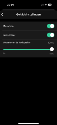

these are the settings:

Undo 'Microfoon dempen' and 'luidspreker' and try again.
Unfortunatly it had no effect.
