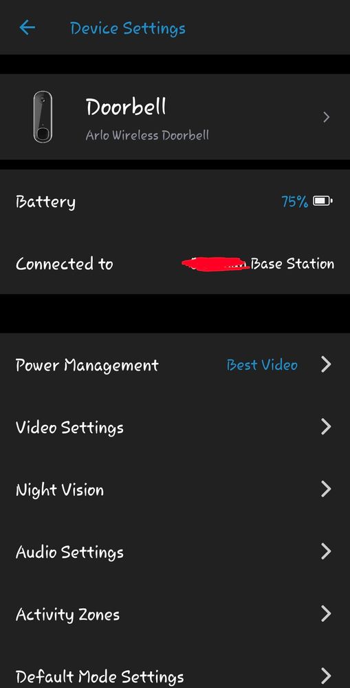

I don't think Arlo has a real answer for this. My doorbell is sitting at 75% currently. Based on what support told me it should trickle charge (no indicator btw)
after it reaches a certain number (appears to be different depending on who you talk to). I thought maybe it would trickle charge at night when there's no movement from deliveries, guests, kids etc. But no it doesn't. I haven't had it die on me YET so I've just given up trying to figure out why the battery even discharges if it's hardwired ¯\_(ツ)_/¯
