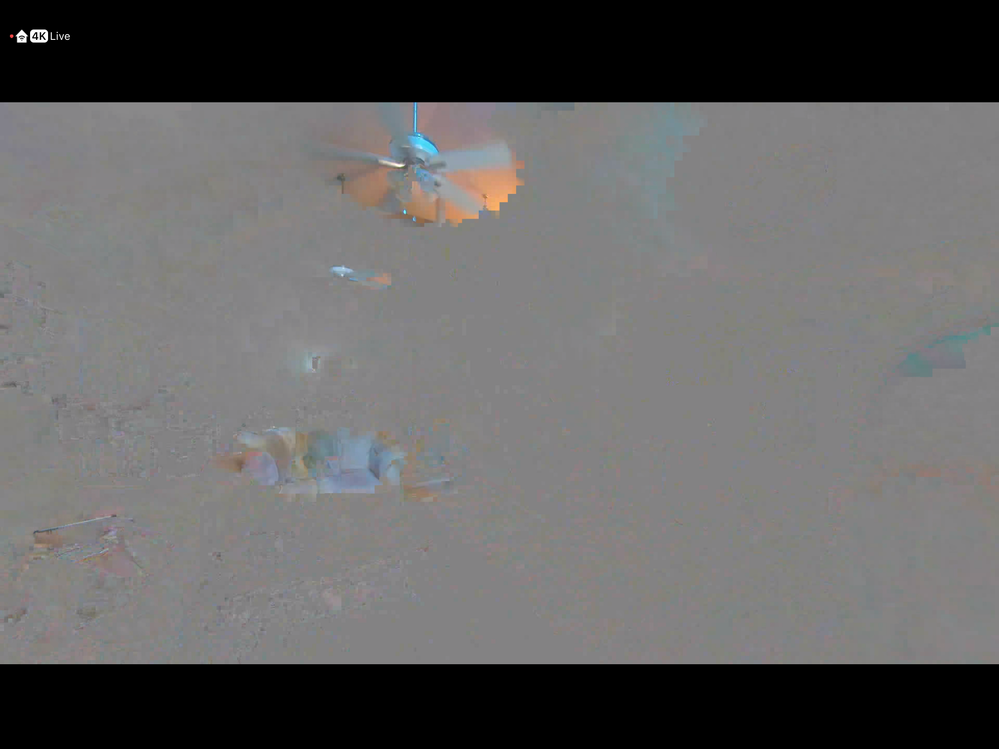

I still don’t see how these are classified as 4K. I downloaded a 14 second clip and the file size was less than 4Mb. I have still image pictures greater than that. When I can connect in 4K I get a display that is constantly washing out as in the example photo.
All firmware is up to date, plenty of bandwidth available, plugged in, rebooted, etc...
Something is wrong here. My 4k videos are crystal clear. This looks like the problems that I had when I first got my Ultra system but firmware updates solved that for me. I will let JamesC handle this for you as I don't know if it is a hardware issue or not. Have you tried 1080p recordings and is this happening on more than one camera? Have you tried to power cycle your base?

Yeah, I am not close to that resolution.
It happens on all of my cameras and I just tried power cycling again. Still have the issue. The issue does not happen in 1080p, but the attached photo is the quality I am now getting in 1080p. At least the 7 Mississippi lag is only 3 at 1080p.

Let's see what JamesC has to say tomorrow. I hope he has an answer for you. Are you in the US? What is your upload speed? What is the signal strength of the cameras? You might try to pull one camera inside close to the base and see what happens then.

Thanks. I am in the US, have an upload speed right now of 21 Mbps. The camera I am using for my example has a full strength signal as it is just a few feet from the base station.
Ok, your upload speed is more than adequate. I am on the Spectrum Ultra plan - 400down and 24 up, so we should have similar speeds. Do you get the same problems when you use the web client? Have you looked at what channel your 2.4ghz is on? In my area that band is very crowded, so I put my router on channel 9 as it is the least crowded. You might want to try different channels, such as channel 1 or 11. I hesitate to ask you to do a complete factory reset and add everything back but that might solve the problem. Let's hold off on that until other avenues are explored. You might try to remove one camera and add it back in and see if that helps. One other thing is to move your base a little further from your router.

One final thing. Do you by any chance have a Micro SD card inserted into the base and if so, are the recordings corrupt there?

There are still issues with 4K Live streaming. I have the same problem. Sign up for Premium Video Recording and you will get 4K motion recordings in the library. Download one of those 4K motion recording and look at that. It will be 4K resolution and will look significantly better than the 1080p.
The bitrate will only be about 5 Mbps on these videos, because the Ultra cameras are battery powered and cloud connected. You cannot compare these 4K videos' size or quality to an iPhone, GoPro, or similar photography-quality video camera.

@st_shaw The video I downloaded was using the 4K Premium Video recording. I have also bought a NAS and set up a Reolink 5MP (4K is 8MP) camera and the bitrate is set to a max of 4Mbps. The clarity in the 5MP camera blows the Ultra’s quality away. I really want to
like the Ultras as I like the AI that distinguishes what type of motion was seen.

The gray blotchy image you posted above is tagged 4K Live, so it is not a motion recording downloaded from the Arlo library. Download a 4K motion recording from your Arlo library and look at that. You will find much better resolution and image quality than the 1080p Pro 2.
I have a 1080p Axis camera that blows away the Arlo Ultra as well. It's not battery-powered and not cloud-connected either. It consumes 8-10 watts of power. It's a totally different class of prodcut from Arlo. If image quality is your thing and you have a NAS then don't buy Arlo. There are cheaper/better options for you.

Yeah, two separate issues I guess. The 4K live is just that and the video I downloaded was from the library and not live.
As for the Reolink, I am using the C2 Pro connected to a Synology NAS. I can view it remotely with great image quality. I like the convenience of Arlo and not trying to set my house up with PoE cameras though. Might just have to bite the bullet and install some switches if I am going to expect better image quality.
