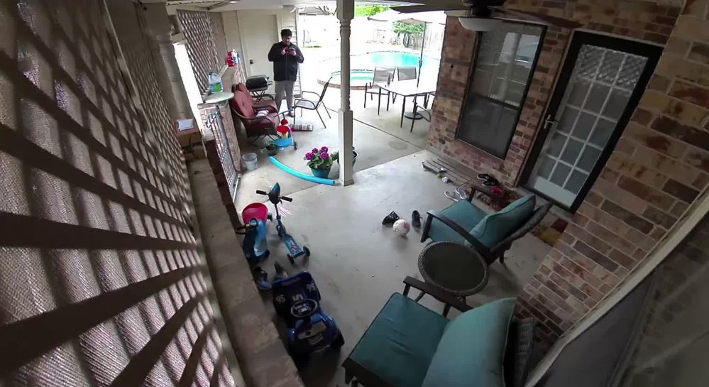

I can't get my motion sensors to work further than 6 ft. I set sensitivity to 100 percent. I also verified it's not working in motion test mode. Any tips? My camera height is around 7ft
13 REPLIES 13
Distance and motion direction seems to be the problem since most motion within range is more or less at the camera rather than across the FOV. Read the FAQ here on best camera positioning. Also, make sure you're setting sensitivity in your modes and rules, not in the motion detection test.

I didn't have this problem with the arlo pro 2 mounted in the exact same location. I am currently using the wide setting not the 180 deg extra wide

mlb1,
Do you have more than one camera behaving this way?
mlb1
My other (driveway) camera isn't as active as the pro2s but it's not as bad as this one.
Community Manager
Community Manager
mlb1,
You might try swapping the camera that isn't behaving as well with your other camera as a test. This will help isolate the issue to either the camera or the location.

Detection is not close to the Pro 2.  My ring can detect people in our court.  Pro 2 could also.  Ultra cannot.
Private drive behind my house has cars every once and a while.  Pro 2 could detect it.  Ultra cannot.

Post a screenshot of the camera view. For the notification delay, are you using Arlo Smart? The video has to be uploaded and analyzed before sending the notification. 4K videos are bigger and take longer to upload and possibly analyze.

You might try angling the camera up a bit more. On the Ultra the top 1/4 of the image area doesn't respond to motion. You can test it by checking in the camera's settings->Device Utilities-->Camera Positioning. It'll show the inactive area with a dark grey band.
Also remember that PIR sensors detect best side to side, not at the camera. The probable usual direction seen from your image seems to be at the camera.
