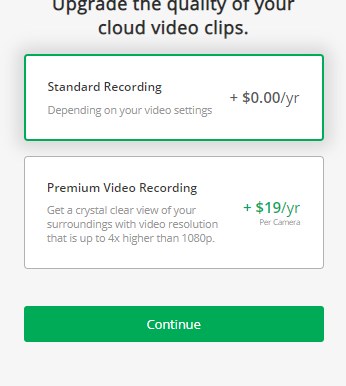

After step 2 and 3 you should see this:
Select Premium Video Recording and click continue.

After clicking change plan, are you clicking continue (making no changes to the account level subscription)? What screen is shown after you've clicked continue?
Well, I'm not sure what happened, but that option is there now. I'd bet my life it wasn't there earlier. Maybe because it was a new account?
Anyway, I think it's good to go now - thanks for the help. And just to confirm, are the videos being saved to my SD card 4K, or do you know.
