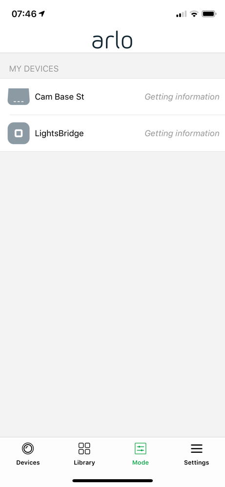

The only way I’ve found to fix it is to uninstall and reinstall the app from the App Store - which is annoying as you have to go through all the default prompts and app authorizations every time you do it. That only fixes the issue for one or two logins before it’s stuck on the same issue again.
I’m using an iPhone XS Max on iOS 12.4.1 and the new Arlo app v 2.8 (not the old legacy app)
Arlo Mobile app version 2.9 is now available for iOS supporting iOS13 and resolving the issue. Please make sure you have the latest version of the mobile app downloaded from the app store.

I have noticed a few times the ‘getting information’ mode as well.
The way I’ve been able to fix it by force closing the app x2 to 3x in a row.
It was not doing the ‘getting information’ thing when I had the old Arlo app.
Unlike the other guy posting here force closing the app and reopening it does not allow me to move past the “getting information”.
I do notice that disconnecting from my WiFi and going on cellular resolves it - and as soon as I get back on WiFi it does it again.
I have no changed any router settings or had any issues with the other 40 wireless devices in my home. I did reboot the router and cable modem for good measure - but it’s still happening.
Having the same issue on iOS 13
My Arlo pro 2 is having the same ussiue “getting information” if I change from WiFi to cellular I can get it to work, sometimes.
i deleted both apps and started from scratch, without luck.
Deleting the Legacy app does not solve the problem. The only way to arm/disarm ones system is to use the Legacy app.

Tried that..still not loading up the mode page..back to legacy for me. Anyone else got any ideas?
Using Arlo app 2.8(909) on a iphone 6S and iphone 10. Not able to access Mode functions consistantly. Seems to work 1 out of 10 times. No issues changing Mode from the web browser.
I have the same issue on iOS 12.4. I have tried all suggested fixes and none work. Un-installing and re-installing works for a few times as someone else suggested but that is a terrible workaround.
The only way to set the mode is to use the Legacy App to set the mode.

I have experienced the same ongoing issue with the new app stuck on "getting information" in the "mode" option. Numerous shutdowns, reinstalls etc have not resolved the issue. In the end I have re-installed the Legacy app to manage the Mode functions (without fault). Hopefully this bug is fixed before the September 30 deadline.
Running on IOS, iPhone X and IPad Pro (same issue on both), the same problem being reported by so many people indicates it is definitely an App software bug that needs to be fixed before Sept 30.

when i change from wifi to cellular and restart the app, I am able to change the mode. It’s not the solution but it might be usable at the moment.
i am using iPhone 7 with software version 12.4.1
It's probably worth removing and reinstalling the app (though no guarantees that will help).
Yep - add me to the list, stuck on 'Getting Information', happens on iOS 12 and 13, with or without the Legacy app installed. This sorry state of affairs combined with the utterly horrendous initial setup of the system makes me wonder if it was worth buying at all. I restarted my hub in the hope that might solve it but no, all it did was lose my doorbell which had to be deleted and reset up as a new device to get it to work again.

Switching off WiFi and using cellular is the only way to get the system to show the hub mode and allow changes built that doesn't help with the geolocation problem.

My system is stuck on “Getting Information” in the mode tab of the iOS app. This has been issue since I got the new (non netgear affiliates) app.
Never had this issue with the old app, but I can’t use the old app for long, so will this be fixed? 😞
Same issue here with new app, on mode screen hub is stuck on "Getting information". I have tried rebooting the base station a couple times. I am unable to change the mode on the hub or access any of the mode configuration. Its pretty unacceptable that I can't access any of this functionality now. Seems like every software update something major is broken.
