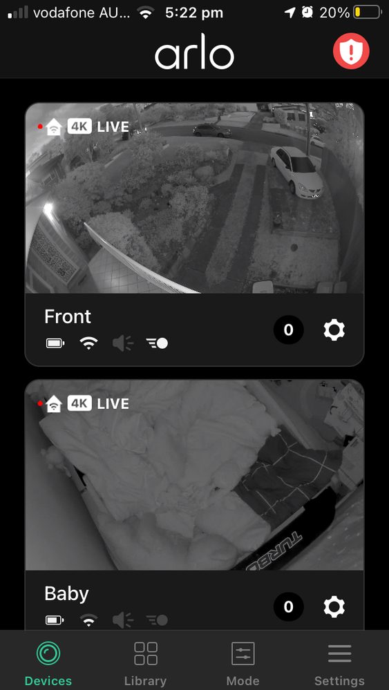

I am getting intermittent live 4K streaming issue. Most of the time I don’t get the 4K icon. I will only get 4K working a few times after I have removed and re-added the:
iOS app
Camera from the app
Base station from the app
This is not sustainable. Please fix this. I have 2 camera and they both have the same issue at the same time.
Hi del13r,
From looking at the screenshots you provided, it looks like the signal strength between your camera and your Base Station/SmartHub is getting a weaker signal, which could cause the 4K local streaming stop. Make sure that your cameras has full signal strength in the area that you intend to install them.
Thanks for sharing those screenshots. Try rebooting your iPhone 12 to see if that helps.
If you still see the issue, try uninstalling the Arlo app, reboot your iPhone again and reinstall the app.
