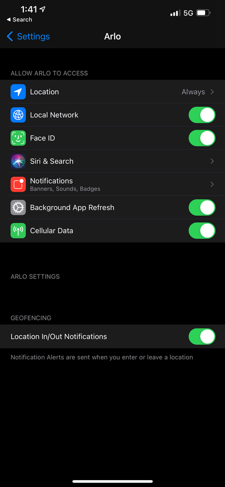

Hope this explains. The app is configured properly in iOS. Yet it still is having issues. Just hope they fix ASAP!
Yes, these are the correct settings in iOS. As you probably know, low power mode is another aspect - if you enable low power mode, iOS will pause background apps. I haven't tested this, but it likely will disrupt geofencing.

The weird part is, the Geofencing works fine when the phone is restarted, and absolutely no apps are running in the background since I close them before I do the restart, but as soon as I open the app, and then close it, as a habit as well, it once again fails to recognize when I leave the area to arm the system. Geofencing never needed the app to be running in the background for it to work, it has location access set to ALWAYS allow, Geofencing IN/OUT notifications are ON, and like I said, it works like it was designed after a full restart of the phone.
