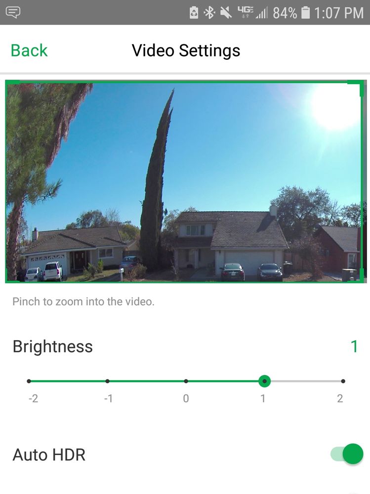

After the update 1.070.50.0_197_09137a0 my base station would go offline once motion recording from 1 of my 4 cameras.  I rebooted the base, removed device, pulled battery and the added to system again.  Now when I try to setup the motion zones the picture is 1/4 of the view, I only see the top left of the camera view to set the motion area.  The camera shows and records the entire view.
Any software patch coming out to fix the motion window image not showing the entire picture?

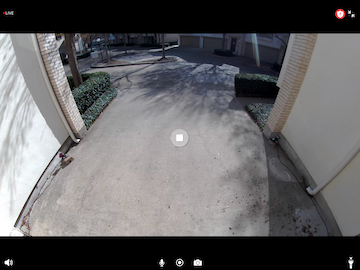

This is the view of live window

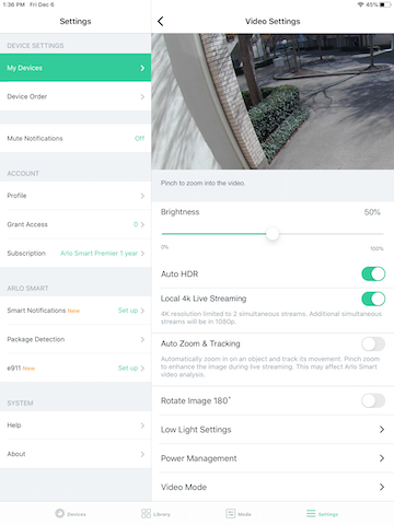

I'm seeing the same issue, I have performed the same steps someone mentioned above.  If you REMOVE DEVICE and re-add it I can set my Activity Zones but as soon as I turn on "Local 4k Live Streaming" the full video snaps to the top right corner and I don't see the whole video area.
I have removed the camera again and only changed the "Local 4k Live Streaming" option on and the issue comes back.
Hope this helps Arlo come up with a permanent solution.
