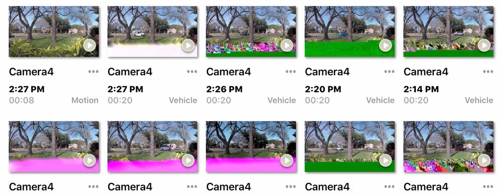

I now know what I did wrong. I had not upgraded my Arlo subscription to add Premium Video Recording in order to record 4K to cloud. All is good now in that regard. I’m having new issues now that I’ve upgraded. *sigh*. Now that cams record 4K, all vids start off pixelated or scrambled. Attaching a screenshot.
How far is your SmartHub from the camera? You might try elevating the SmartHub to see if this improves the signal.

The camera in the photos actually has a very strong signal. The base station is maybe 15-20 feet away.
I figured out what was wrong with the video quality being so poor. I hadn’t upgraded subscription for 4K which was an additional $95 annual for 4 cameras. The pixelation I haven’t figured out.
