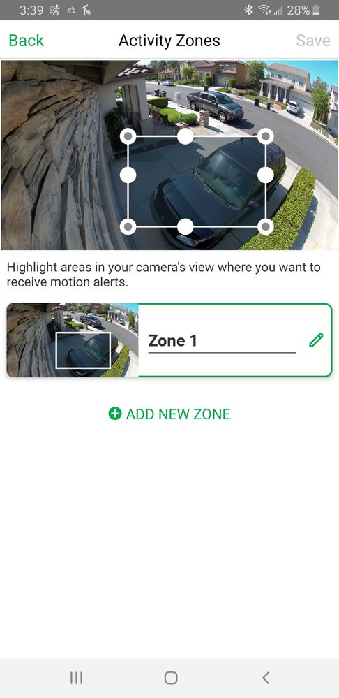

I’ve looked at previous threads referring to what seems to be an issue for others around activity zones, but it seems that the suggestions don’t solve my issue.
The Problem: Excessive alerts and notifcations despite activity zones.
I’ve attached a photo of the Activity Zone along with a clip of a truck that’s clearly outside of the zone. In other posts, I’ve read that I need to use a different mode outside of the “Armed” mode which I’ve done. I’ve also turned off Vehicles and All Other Motion Smart Notifications which have resulted in the same issue.
Looking for any other suggestions
So I just last night got my activity zones to work correctly. My library is still full of clips of cars going by but i am not notified unless activity happens in the zones I specify. That will continue until I get back on the ladders and try and position only the top 1/3 of the field of view in the street.
All I did was set my zones and after everything was configured how I wanted it, I reset my Hub. this solved the problem of excessive and unwanted notifications. I believe I also have the Smart thing checked to ignore vehicles. I would suggest getting it all set how you want it and then try restarting the hub though the app.
The only other thing I've done was what a few people suggested and under Mode I created a new mode, called it Activity zones, and set this mode up for use with my custom set activity zones. I am not sure if this is also necessary, it does not allow me to schedule my system by date/time while doing this but its worth it if it allows me to only be notified when I want to be. Let me know if this works for you. If not we can go through my settings piece by piece and find out what works. Good luck.

Late last night , a back end fix went out to address this issue. Please test activity zones again to see if you still experience the same behavior.

Try recreating your activity zones to see if you still experience the same behavior.
Thank you,
Hi James,
many thanks. Took me a while to test, for some reason it took my battery almost two full days to recharge. But my initial finding is that it really seems to work. I tested by walking through the activity zone, and the camera recorded it properly. More importantly, so far none of the cars passing through outside of the activity zones have been recorded. These made up 99% of the 1000+ recordings daily that drove me mad.
I did delete the activity zone and created a new one before testing, and it seems to work as I hoped for.
I hope my battery issue was just a fluke, but I appreciate that the fix was rolled out. I think i will start enjoying my Arlo ultra again 😀
Pascal
