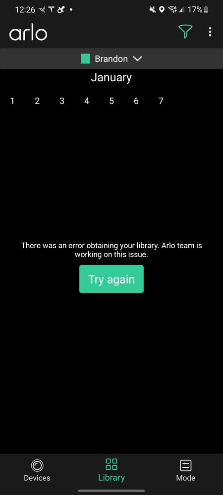

After the update of the Arlo app on August 22, 2022 , when I try to access my Smarthub,I keep getting this message: There was an error obtaining your library. Arlo team is working on this issue. It has been almost a month and it is still not working!!

When I choose my local storage in the Android App, I get:
"There was an error obtaining your library. Arlo team is working on this issue."
This is what I did so far:
I tested formatting through the Android app and also with my laptop. The videos do record properly on the micro SD but are still not viewable through the app.
I resetted the base VMB5000 to factory default.
I also resetted the cameras to factory default.
I also poppep OUT/IN the batteries and resynced (readded).
I also uninstalled the Android app (thus cleared the cache / storage ) and reinstalled.
In the Arlo android app, I still get when choosing the local storage:

Same behaviour on both Samsung devices. If I can connect my microsd to my compter, I can view the video recordings. In the library, check attachment:
