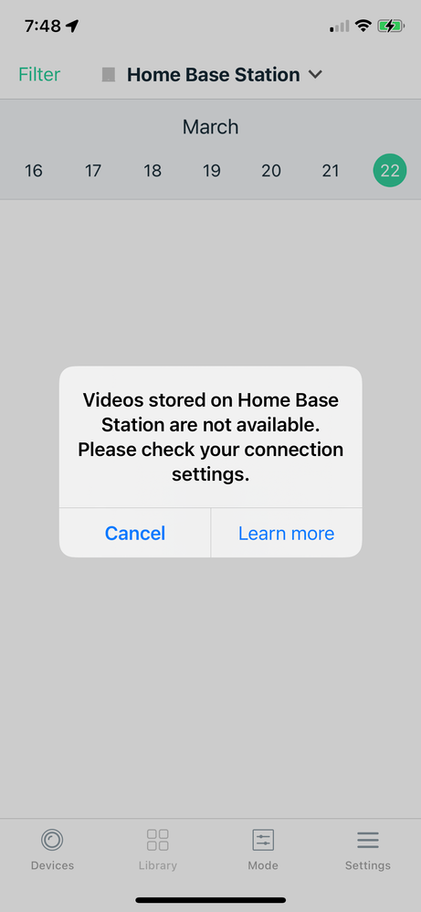

Still getting "Videos stored on Home Base Station are not available. Please check your connection settings." Clicking on the "Learn more" button uselessly takes you to the Arlo main website.

I'm not 100% sure on the OP's issues, but mine is local area network access on local storage when on my iPhone connected to the same LAN. It hasn't worked since the first week I had it (about a year). I have up-to-date all things, running on iOS, and have been paying Arlo a monthly subscription because, against what it advertises, I can't access my storage WHEN AT HOME.
I haven't even bothered trying a VPN because I want access at home first.
