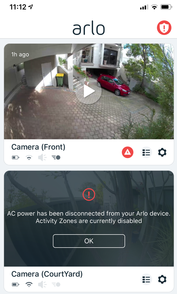

Can you help sort me out: this very annoying notification will just not go away…
After my Smart Subscription expired, I decided to “give it a try” without the added functionality.
Yes, I understood that Activity Zones, and identification for people, animals, etc, in motion detection would be forfeited, and am prepared to accept that.
And basically I am happy with performance (and the improved responses).
But I am not at all happy to see this erroneous notification every time I open my iPhone or iMac app.
Please…. A simple acknowledgement “Yes”, I understand and accept that Activity Zones are currently disabled” to make the notification go away, and please change the notification say what it really should be saying!

Are you getting the complete message: "AC power has been disconnected from your Arlo device. Activity Zones are currently disabled" or just partial message " Activity Zones are currently disabled"?
If you are getting the complete message, then as this thread indicates, [Ultra Wire Free camera] Arlo technicians have never provided a rational for (or even comment on) why it started and, at least in my case, why it stopped and a new one started. Good luck!
If you are just getting the partial or shorter message, as obvious as it is to you, I suspect the marketing folks felt that annoying you to add a feature would enhance the company reputation, and you'll keep getting it as a friendly reminder that you are missing out on features that you have clearly opted out.
Since they would not respond on the technical issue or even admit that the manual and other brochures do not address the problem, I doubt you'll get satisfaction. I hope you do! Good luck on this one too!
I am seeing "AC power has been disconnected from your Arlo device. Activity Zones are currently disabled"

OK, I have a work around in place; very simple...
On the iOS app, for each Camera...
Select: Settings, Activity Zones, and delete all or any Zones that have been configured. Once deleted, the annoying error message will no longer appear.

I have been getting this warning for the past few weeks and am still getting it so this is not a resolved issue. Batteries on camera are fully charged and the activity zone feature still notifies me when there is movement.
Is a fix available?

But as I said earlier, in the interim, you can get rid of the erroneous "AC Power..." messages by deleting any previously configured Activity Zones (on each Camera), as follows...
Select: Settings, Activity Zones, and delete all or any Zones that you may have configured. Once they are deleted, the annoying and erroneous "AC Power..." error message will no longer appear.
West307,
Without an Arlo Smart subscription, you do need to delete the Activity Zones from each Camera.
The cameras will still pick up movement, but now it will be looking at the whole screen.
Activity Zones linked to Arlo Smart subscription being enabled, why I do not know.
But as I said, if:
a) you do not have an Arlo Smart subscription, and
b) you delete the Activity Zones from each Camera,
then the nuisance "AC Power has been disconnected" goes away...
