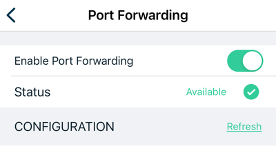

Everything has been working perfectly for almost 3 years. We recently invested in the 3 x Pro 4 (that come with the iCloud Secure Trial). I am aware that when ‘library’ is selected, you have the option to select between the base station and the ‘cloud’.
The recordings are available in the ‘cloud’ for the 3 x Pro 4 (and for some reason the 4 x Pro Camera’s) but not the 2 x Pro 3 or the Essential Camera. This is all good and fine, but the issue is the Base Station Recording. Although we get the notification that a recording has taken place, the recording will not save to the base station anymore.
I have verified that port forwarding is enabled and still working (see attached screen shot).
I have tried:
- Rebooting the base station 5x
- Re-inserting the camera batteries
- Unplugging the base station power and plugging back in after 10min – 30min.
