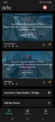

@CodyG wrote:Now when I restart my base device from within the app, my base station doesn't come back online..
not happening here. So how do you get it back to normal?
Alex
I have to unplug it and then plug it back in. When I was home earlier I was able to view my cameras love, see my recordings (locally stored).
And as soon as I left I thought you myself, did I forget to turn my front door camera back on, went to check in the app to make sure and it said it was offline.
So from going to working right before I left my Wi-Fi to on Cellular driving down the road it somehow stopped working.
I'm at work right now, so I wouldn't know if someone was breaking into my home or not..it's just not a dependable product.
I will admit I did buy a refurbished set of 2 cameras and base station off of Amazon 3.5 years ago, so that could be why I'm having so many issues.
But after being on these forums, it's not just my setup, many others that purchased brand new equipment are having the same issues if not worse..
What's even weirder, is when I just got home now, my cameras are recognizing movement and the camera's flashlight or flood light or whatever you wanna call it, is coming on. So it's acting like it's recording but I'm not getting the notifications because the app is showing my system as offline.
And the base station shows an amber light as opposed to the online blue light.
Check if the extender has dropped the connection. You might need to power-cycle the extender.
The extender and the hub are very close, so it is also possible that the two devices are interfering with each other.
It hasn't, I'm currently connected to it. And it has connectivity as I turned off my cellular data to check it.
It has done this before I even bought the extender, so I know it's not that..
Can you ping the base?
When you say the system is offline, are you talking about just the cameras? Or is the base station off-line as well?
