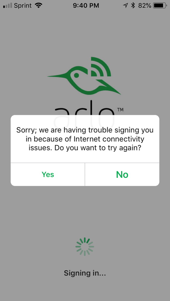

If you are seeing the message “We're sorry, Arlo is currently unavailable. Please try again later” and are willing to help us troubleshoot by providing us with your service provider (wifi or cellular carrier) and device type (iOS, android, web app). Please reply to this thread.

We are looking into reports that some users are still seeing the error "We're sorry, Arlo is currently unavailable. Please try again later" or "cannot log in due to internet connectivity issues". This does not affect library recordings or any previously set modes and rules. We are continuing to investigate this issue, and will keep you updated here on this thread.

We are aware of an issue where some users are unable to login to their Arlo apps, or are seeing the message “We're sorry, Arlo is currently unavailable. Please try again later". We are actively investigating this issue and are working to resolve it. We'll update this thread when we have further information/updates.

It's 28 May, 9:30 PM CST and I am still unable to log into my cameras; still getting “We're sorry, Arlo is currently unavailable. Please try again later”. My internet provider is Spectrum and my cellular provider is AT&T. What seems be the problem over there?
