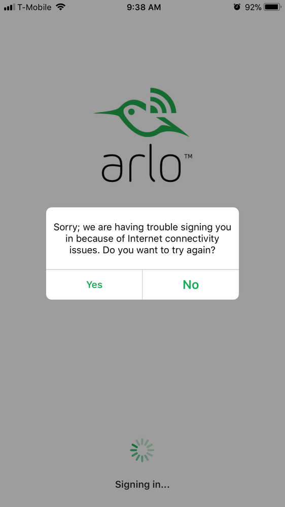

Iphone on latest ios, verizon cell service, mediacom isp. Get error sorry unable to connect due to internet connectivity issues when on wifi. Turn off wifi and lets me right in. Ive tested seceral other wifi devices all on same network and all work fine (eg ring doorbell, ihome light switch etc.

Iphone user. T-Mobile carrier., spectrum Ethernet connection.
